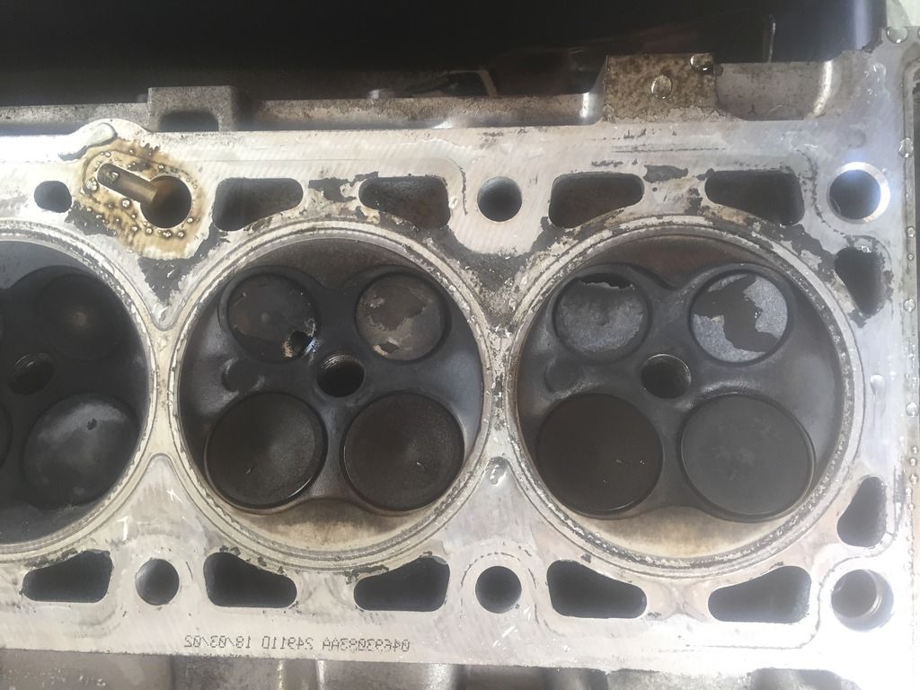

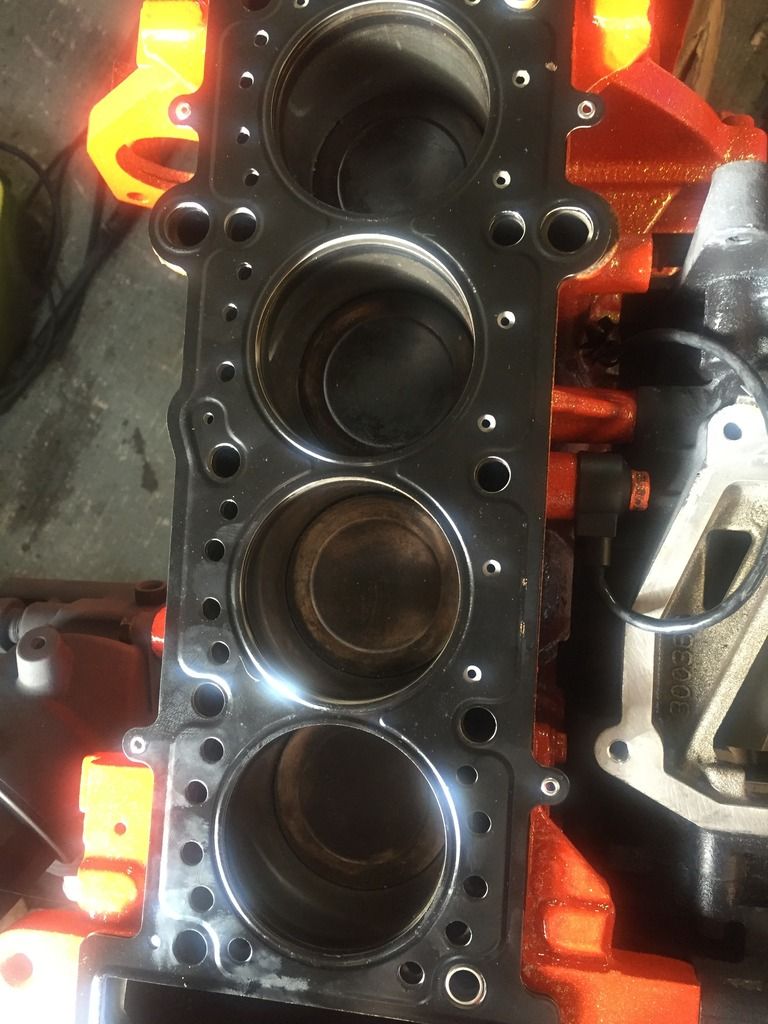

#10 ·
Compression test done and results probably speak for themselves:
Cyl 1: 162 psi
Cyl 2: 0 psi
Cyl 3: 172psi
Cyl 4: 172psi.
Spoke to the garage that usually does my aircon, and explained what's happened so far.
He immediately asked if my Mini had the supercharger and said that it was probably a burnt valve.
That's out of my league, so he's coming next Mon to tow it to the garage.
At least I've taken off most of the parts, so he can access the head without removing everything that is normally in the way.
