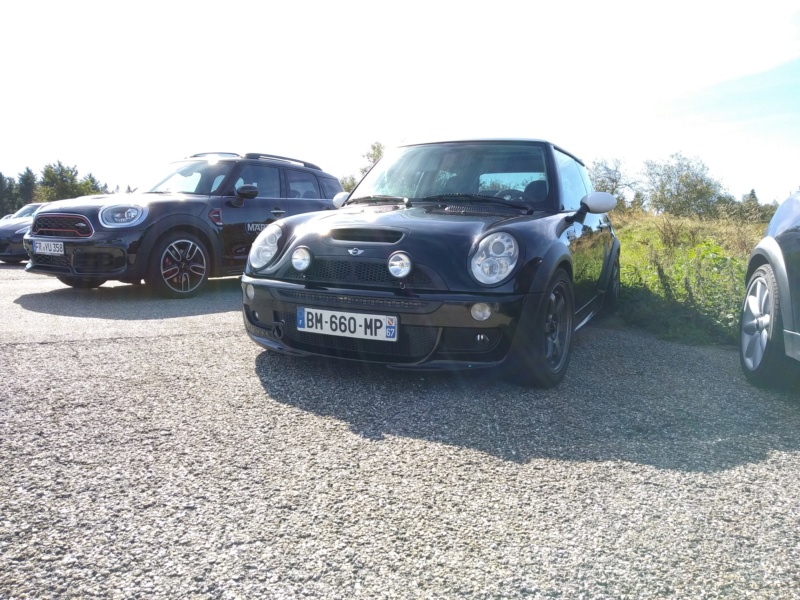

Quick update, this is happening :
It needs a bit of love and repair tho...
Aero kit?
Yup, full kit. With some bonus pieces that gonna be sold like aero rear wing, CC wheel arches and grills.
The front bumper really is trashed tho.. I don't know if I'll be able to repair it.
But for the price I paid it, it's not that bad I guess.
Well, it's been a long time since I posted something here,
I repaired the full aero kit, it was a shitload of works as it was so trashed.. I'll post some pics of that ASAP.
The car now run an OBX manifold with a homemade tomcat to a R52 Non-res milltek cat-back. It sounds amazing, my neighbourgs loves it :thumbup:
I recently start to wrap my dashboard with some glossy carbon vinyl, it's clearly perfectible, but for a first shot, I'm more that happy with the result. will post some pics ASAP too.
And I plastidiped the grey rings, for the speedo, vents... in matte black.
Now i'll be time for the big maintenance and bodykit install, coilover inspection as they started to knock, RCA instal ect...
But I miss a door sill, do someone have this in stock : part num : 51710154680
Will see where all of this leads me, cheers !
