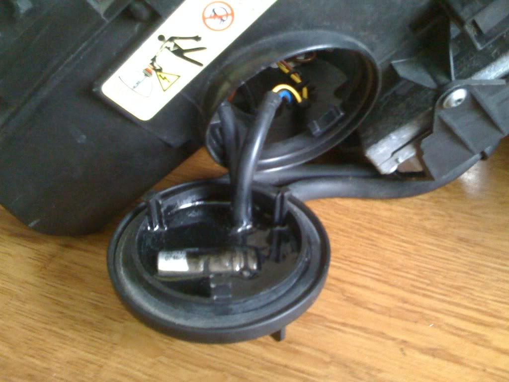

Yes, with a small modification.
I wired a 2700uF 40v capacitor in parallel with the source voltage. +ve terminal to the yellow wire, -ve terminal to the brown wire.
They're neatly encapsulated in potting compound in the inspection cover, but they can also be put into the car wiring if it's easier.

Thanks scraggles! Where would I find this 40v capitator? What is it for in anycase? I'm no eletrician by any long shot.
ahh right cheers, theres one near where i work so i can drop by on the way home. Did you use 1800uF in the end instead of 2700uF like you said earlier?
So do i just splice the yellow and the brown wire and put the capacitor paralell to them? Like this?
Line
Any size over 1800uF would work. I used that size because it was still reasonably sized and fitted into the location I wanted.
Exactly.
