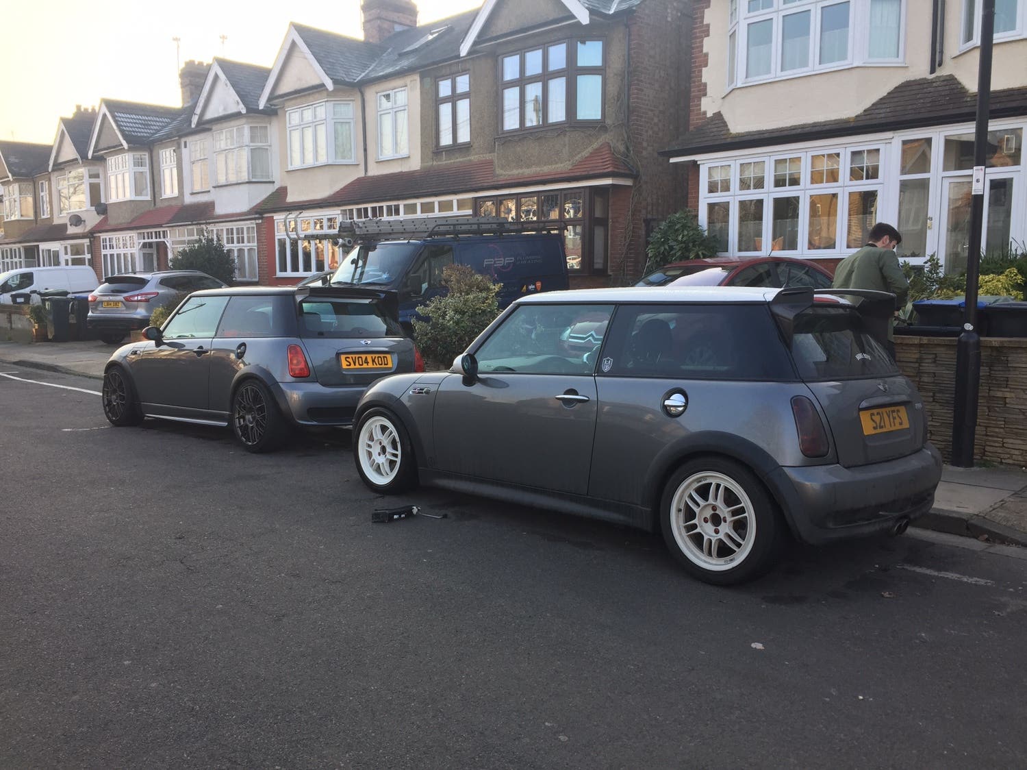

I've been on the look out for some Rotiform BLQ for a while after having sold my last set on the R56 when I sold the car. Managed to find a decent set in the original machine finish and in decent nick, unfortunately they looked shite on the R53 as it looks to race car to pull off shiny wheels. Plus the 17s just looked too big on the R53 so the wheels were off within 4 hours of being put on [emoji1360] and I've given them to my partner.

definitely prefer those in the last pic haha
