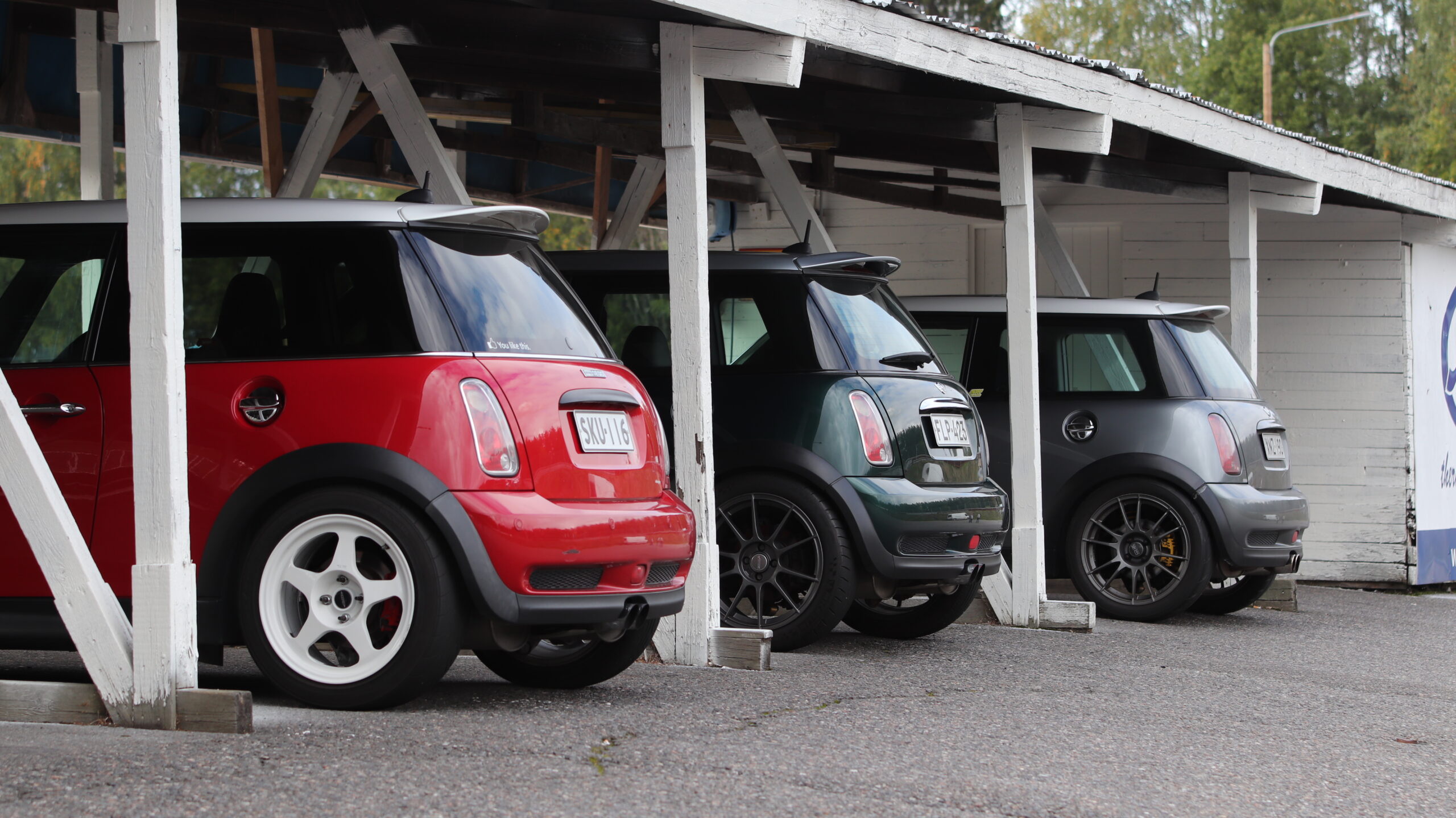

^ from left to right: tcbw (supervisor), JKo (bearded wonder), Micke (researcher)
More like bearded wonderer 😁
I had forgotten about these pics already. Next club track day is right around the corner, hopefully we don't get new repair shots.
