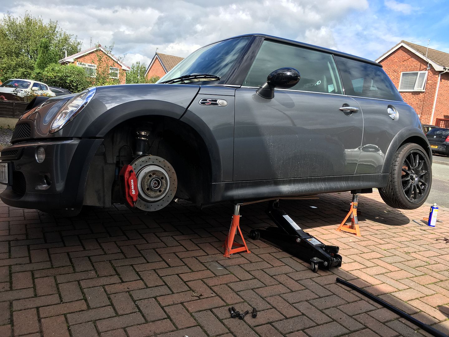

Life with the car hasn't started as I'd have hoped.
The price point I was buying at I knew I'd have a few niggles but work and family commitments and the fact my only trusted garage is fully booked until mid September has meant progress has been slow going on the mini.
So what's happened so far?
Some of this
To find bits like this

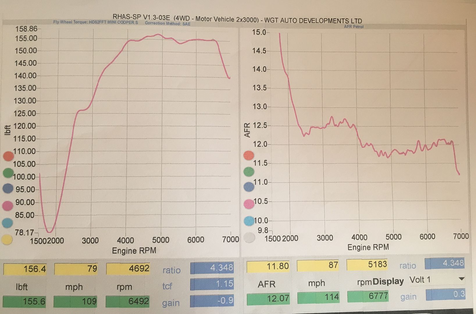

It's also been for a trip to the Dyno to check its health and power outputs
And made nowhere near the power it should've.... But at least it's healthy :crying::laugh:
Since then Its had its open air filter binned for a standard airbox and some boost leaks fixed and an Atomspeed scope added...... And it is feeling much nippier :)
