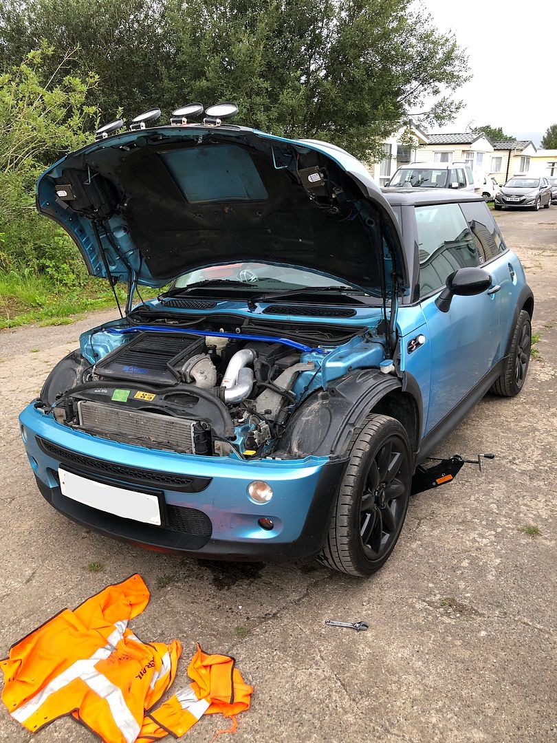

bloody pipe has blown out again, I’m at my caravan in Cumbria this time though, I think I can get it bled with my eldest lad helping!
had a good run up here 160 odd miles including stuck in traffic in the motorway for over an hour with the clutch being pressed hundreds of times and a good blast down the B roads to the caravan changing up and down without issue, get in it to park outside the van and pop!
I’ve got no decent tools with me (or spare fluid) so I’ll have to take my wife’s car into town tomorrow and buy me a 12mm spanner (the One adjustable I have with me rounded the edge of the bleed nipple so I didn’t bother trying any more) then I’ll have to hope me and my eldest lad can bleed it.
I very nearly this morning put a cable tie round the pipe and slave cylinder to make it extra secure knowing I had a long journey but thought I’d be alright, glad it happened now and not on the M6

I think it’s most likely the plastic pipe is damaged or worn, I’ve put a couple of cable ties round it clamping it down to the slave cylinder
Spent far too much time trying to bleed it with the help of my son on the pedal and carsorbikes over the phone, ended up going to Halfords this afternoon and buying an ez bleed kit and got the job done in 5 minutes! Should have done that yesterday really but it’s an almost 50 mile round trip to the nearest Halfords in Workington which I wanted to avoid!
Been out for a drive in it and it seems to be ok, I however have left the clutch pedal pinned down over night with the reservoir cap off to free the system of any more air bubbles
Will see how it feels in the morning
