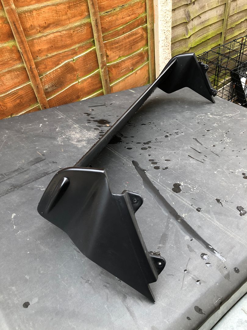

Picked up the spoiler today, hopefully get it fitted tomorrow, it looks tidy enough, it’s fibreglass rather than injection moulded like the orranje one, finished in Matt black, forgot to get a pic of it but it’s like the one below

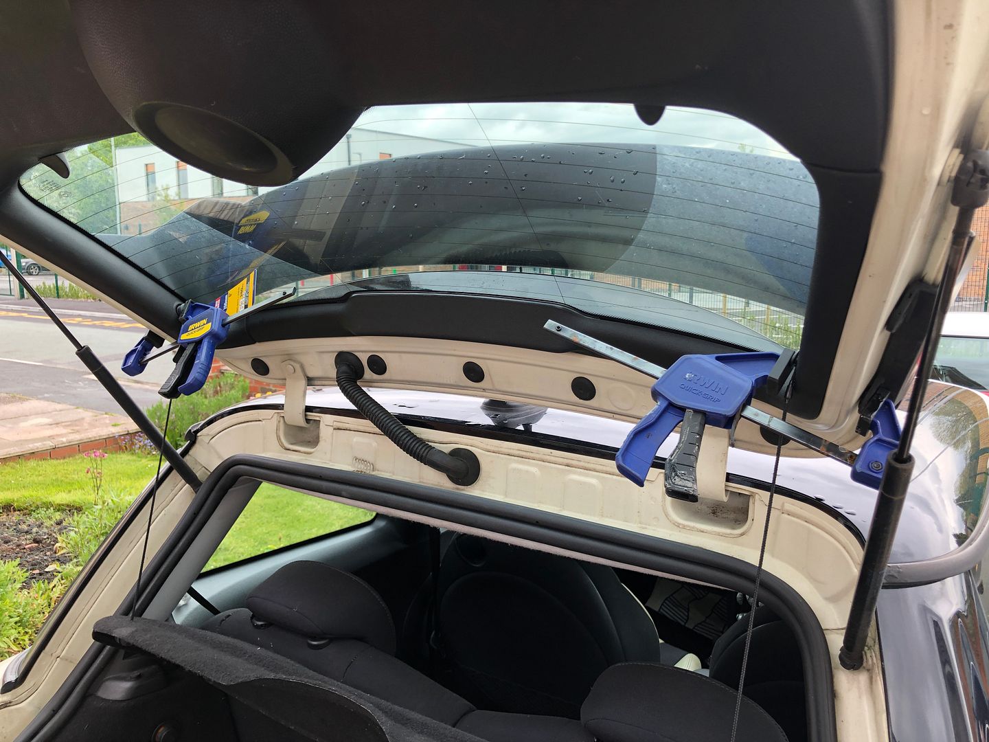

Spoiler fitted

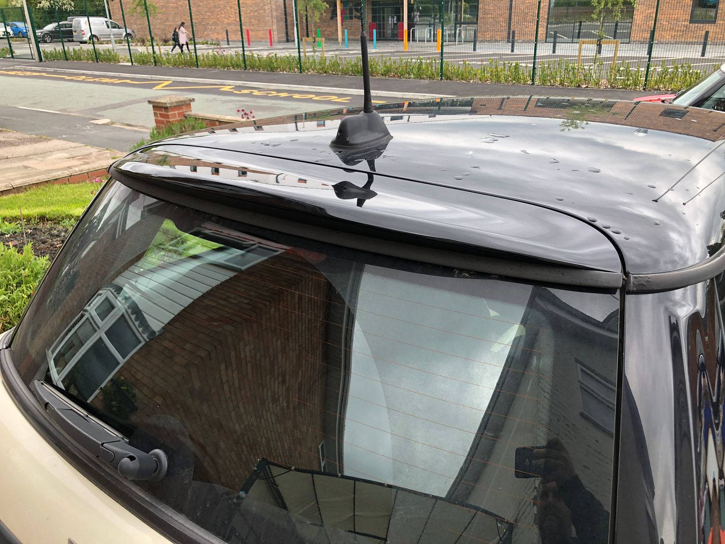

First up was remove the Cooper S spoiler
And refit the original Cooper spoiler

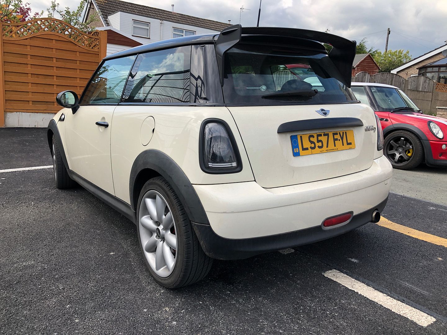

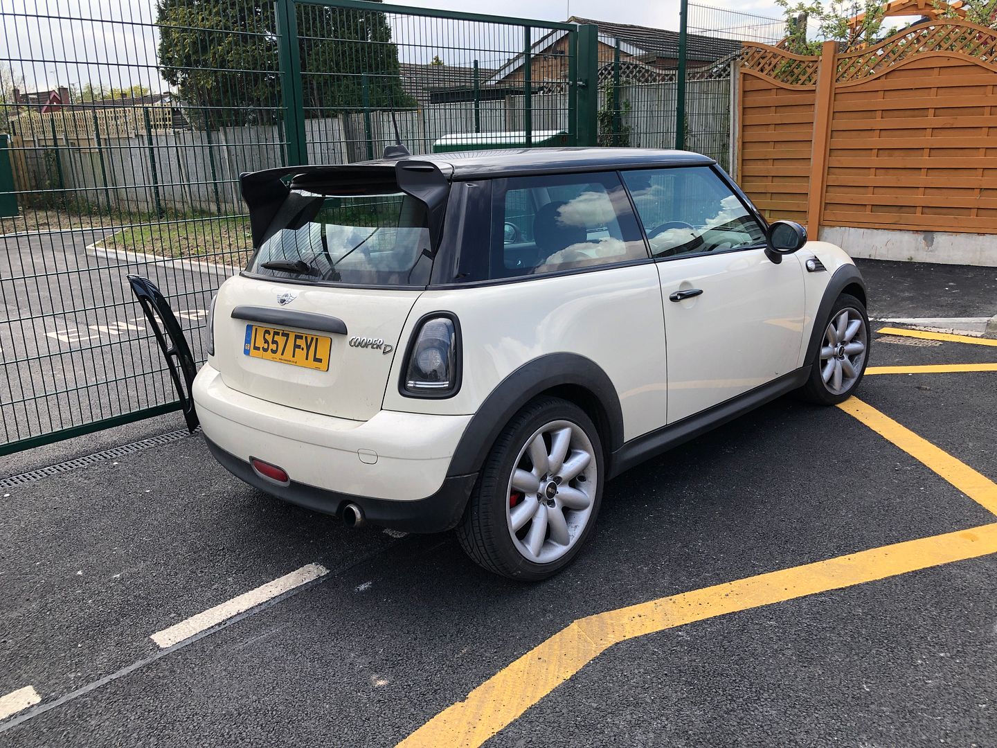

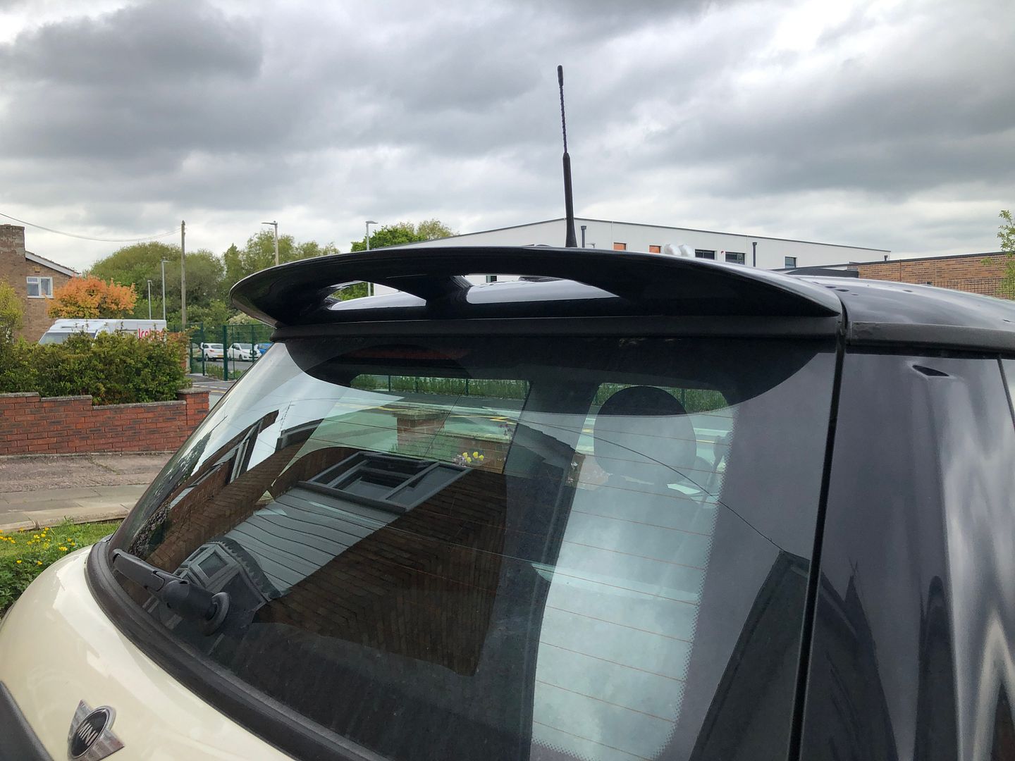

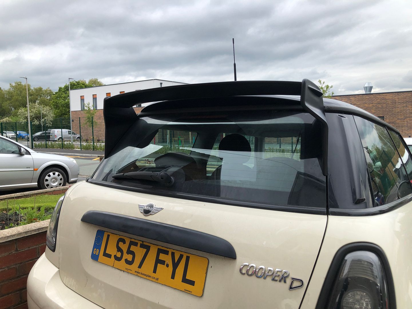

Clamped the new one in place
A few MM down from the gutter strip
I then drilled the holes for the screws, it’s a different fitting to the orranje one which uses rivnuts and bolts, this one has threaded torx screws
It’s not as good quality as the injection moulded orranje wing, in fact one of the mounting lugs began to crack as I tightened the screw into the tailgate but for what I paid for it I’m more than happy!
