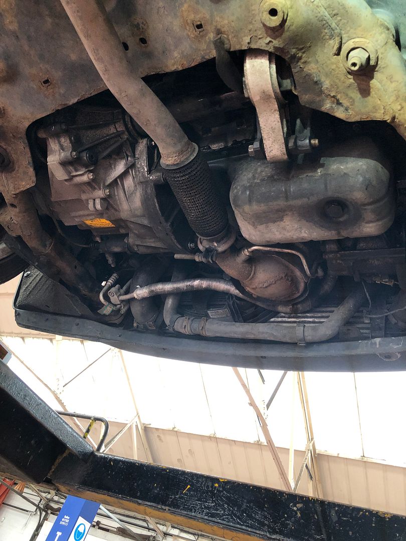

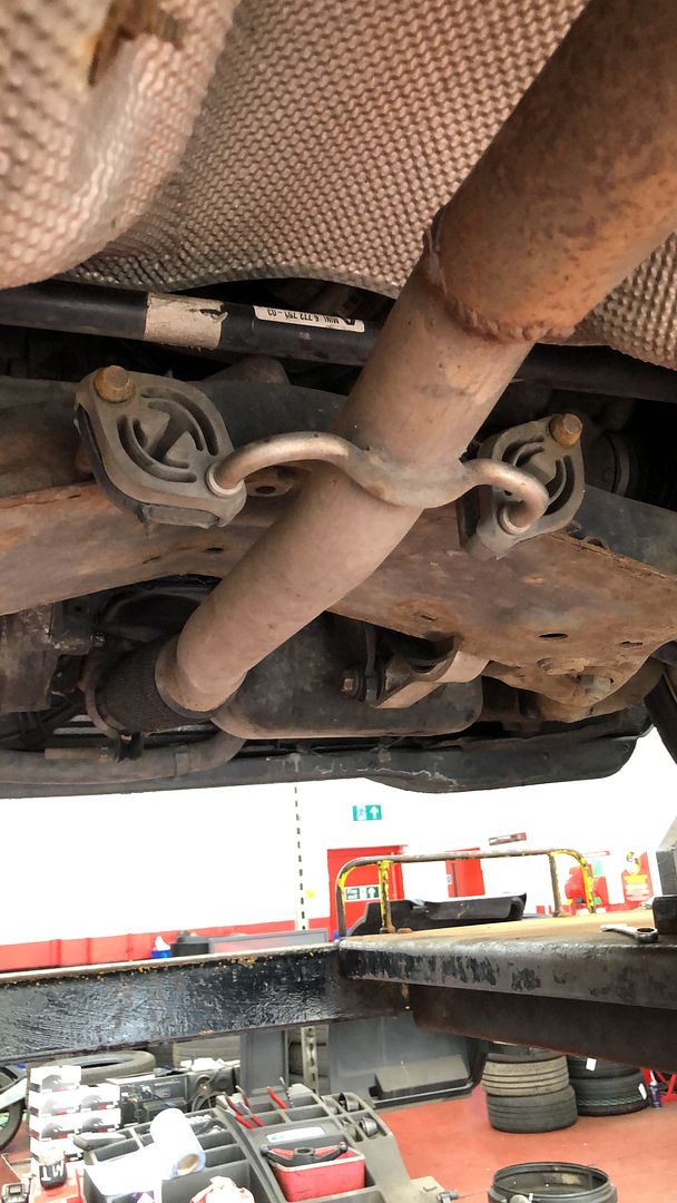

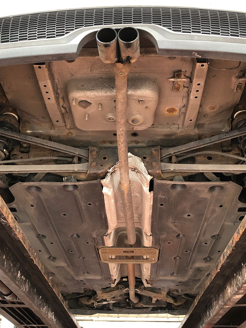

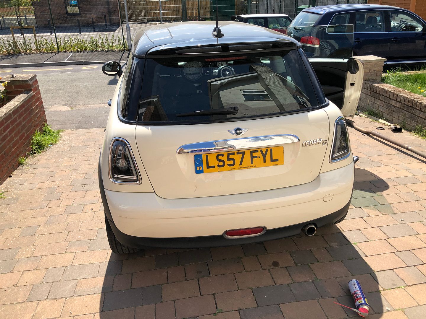

Managed to get a look at the quality exhaust while I was getting the tracking done earlier (which they couldn’t do as the track rod ends were seized) and its sure a quality piece of kit, something Bentley would be proud of!
quite simply it a piece of mild steel pipe welded to what looks likepart of the original front end of the standard exhaust running straight through to the rear, no res box and I wasn’t joking when I said it wa as Halfords tail pipe end!
thing is it works, isn’t at all noisy and looks ok from the back but at some point I’ll most likely get a custom made exhaust on it with a resonating box as I can’t imagine a straight through piece of scaffolding isn’t helping the turbo back pressure, I could look at a Cooper SD exhaust but they are for 2l cars and the manifold may be further forward or back on the 1.6 car so it may not fit, similarly the Cooper diesel exhaust will fit the manifold but it’s a side exit type so won’t fit the bumper, another option is an amalgamation of the two types
It’s also had its heat shield removed so I’ll look at putting that back on if I can find the bits cheap enough

also looks like the cat/dpf has been smashed out if that pic detail is what I think it is? Plate welded over the housing, will fail an MOT (evidence of interference)

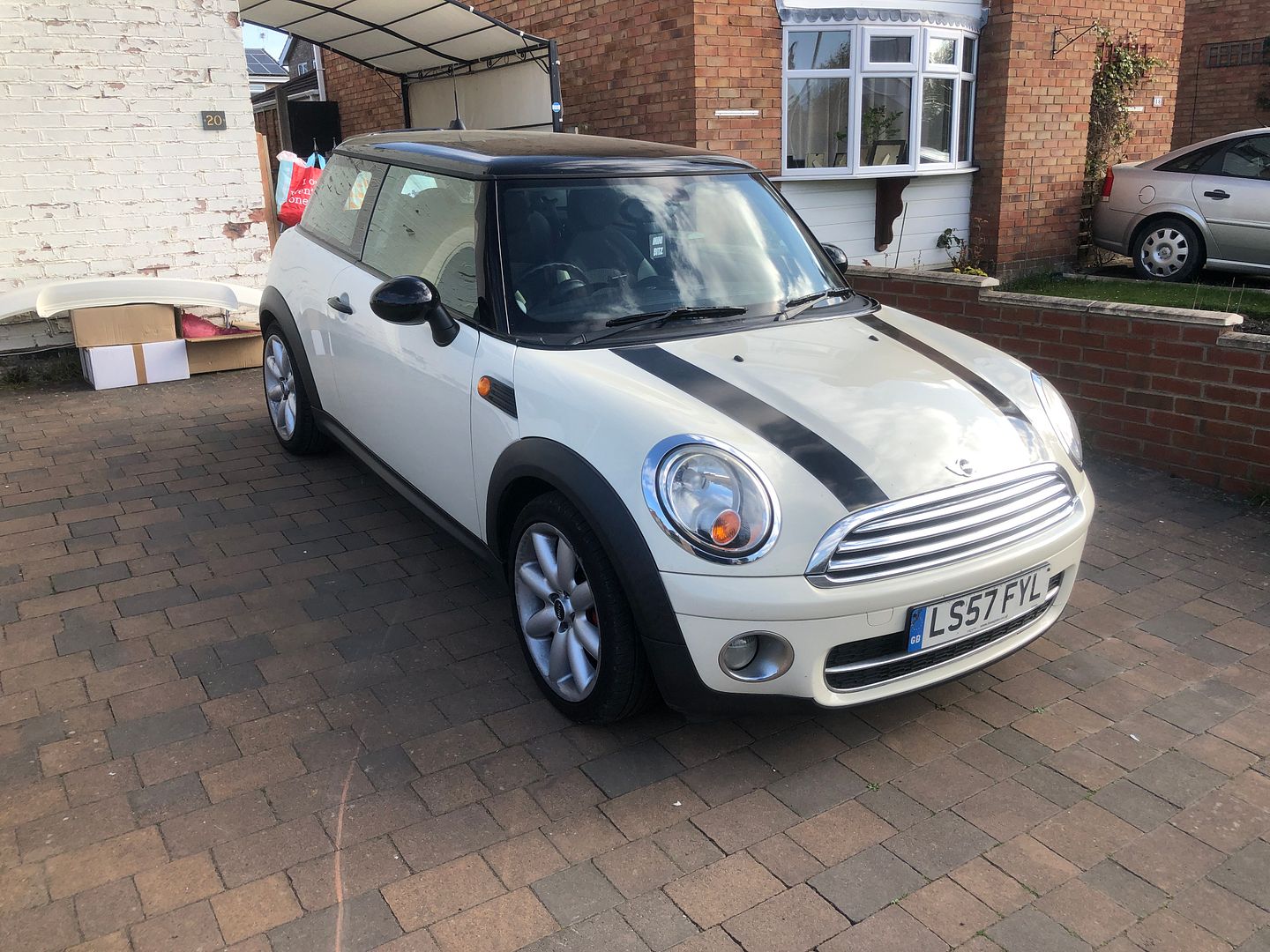

today was the day to try and get all the bits on the car, started about 8:30 and got a good days work done!
here is the car as it looked the start of the day

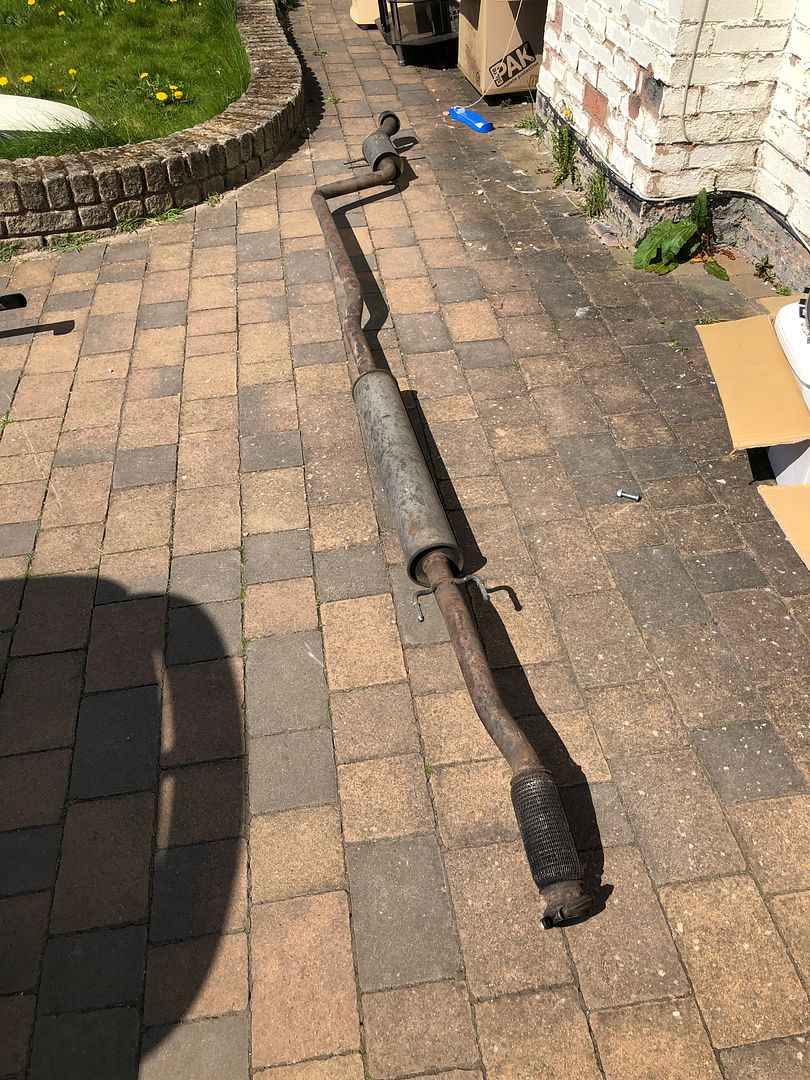

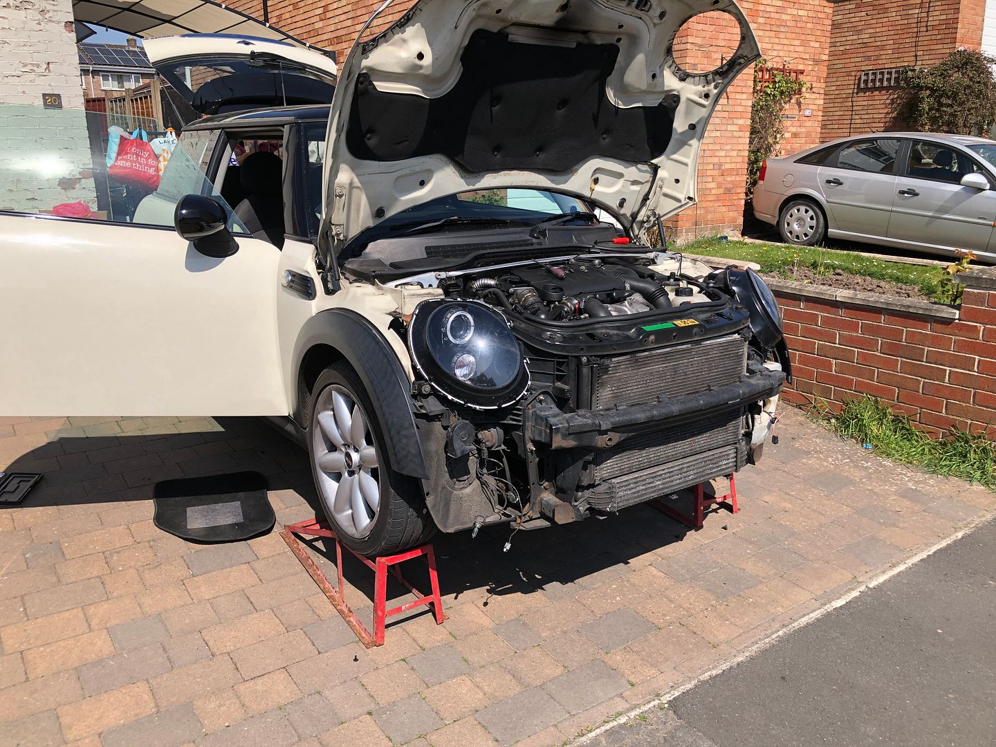

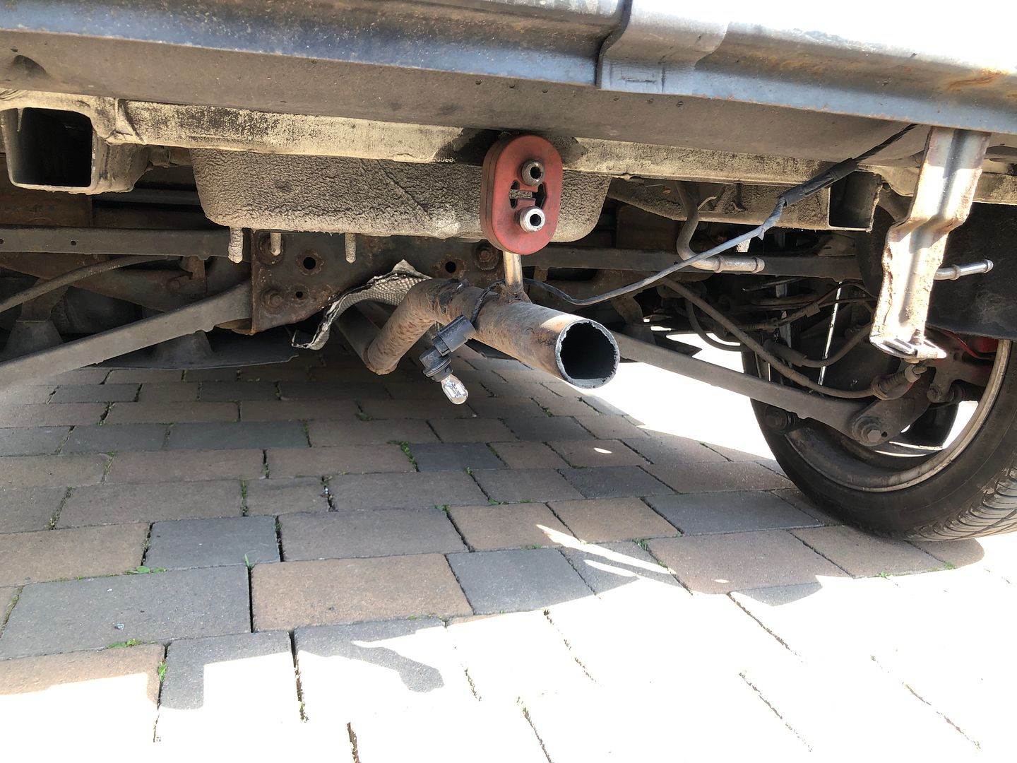

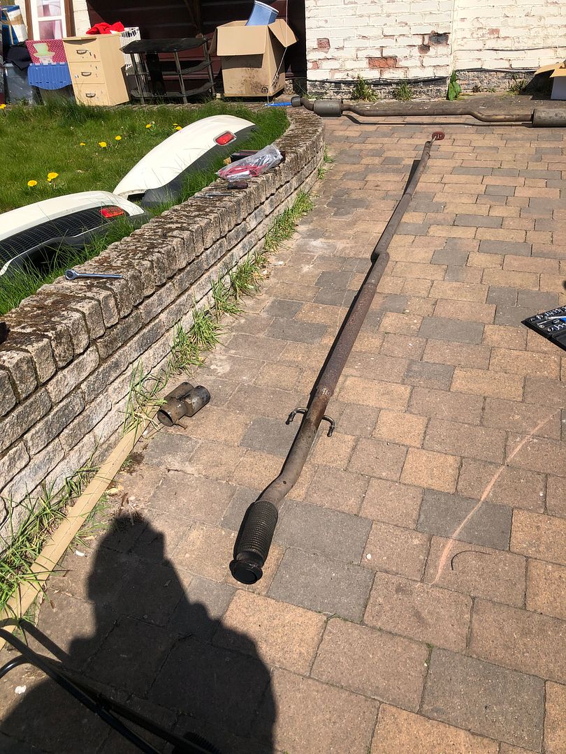

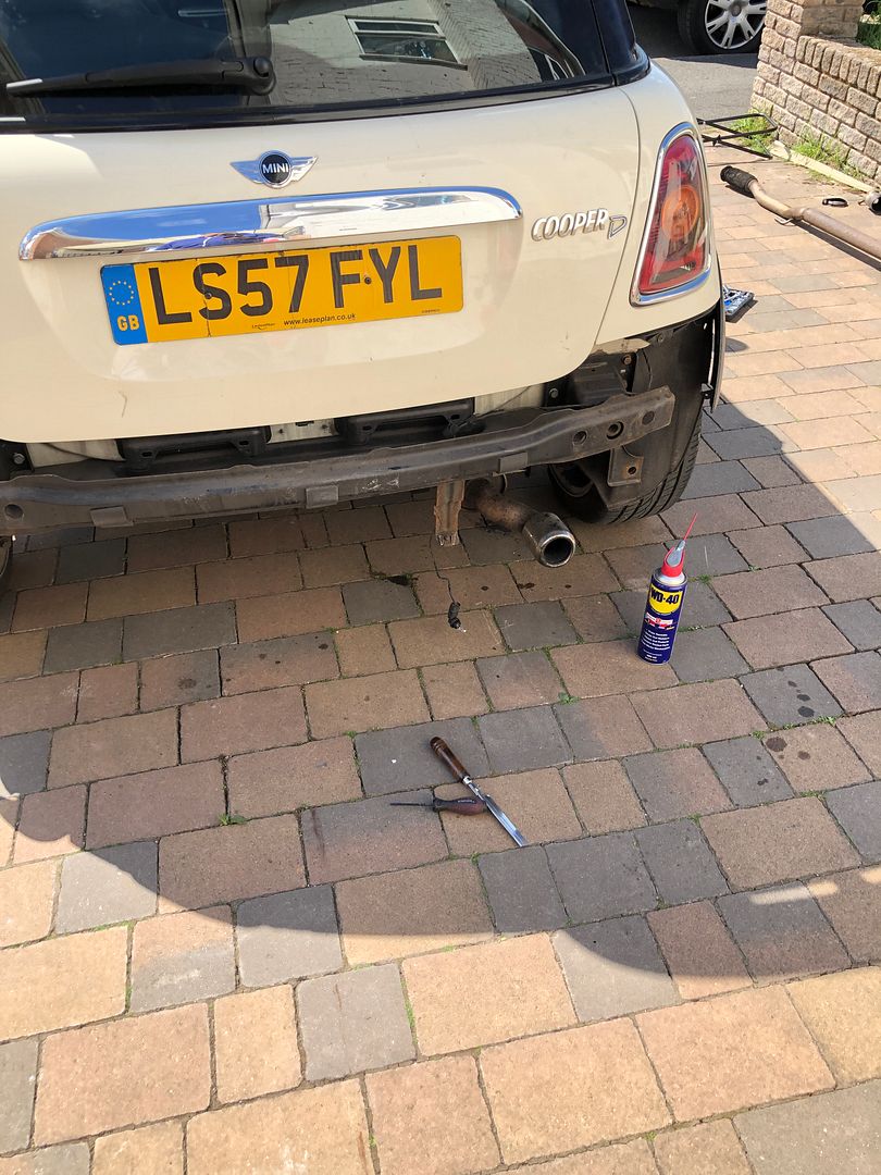

Then it was off with the bumper to see if I could do anything with the exhaust
as you can see it’s top notch!
Then once I was sure I could do something with it i ramped up the front of the car to get to the manifold bolt
I then wd40d the rubber holders for lubrication and yanked the exhaust from the back and it slid off the hangers very easily, in all fairness I could have talked it down it was that loose!

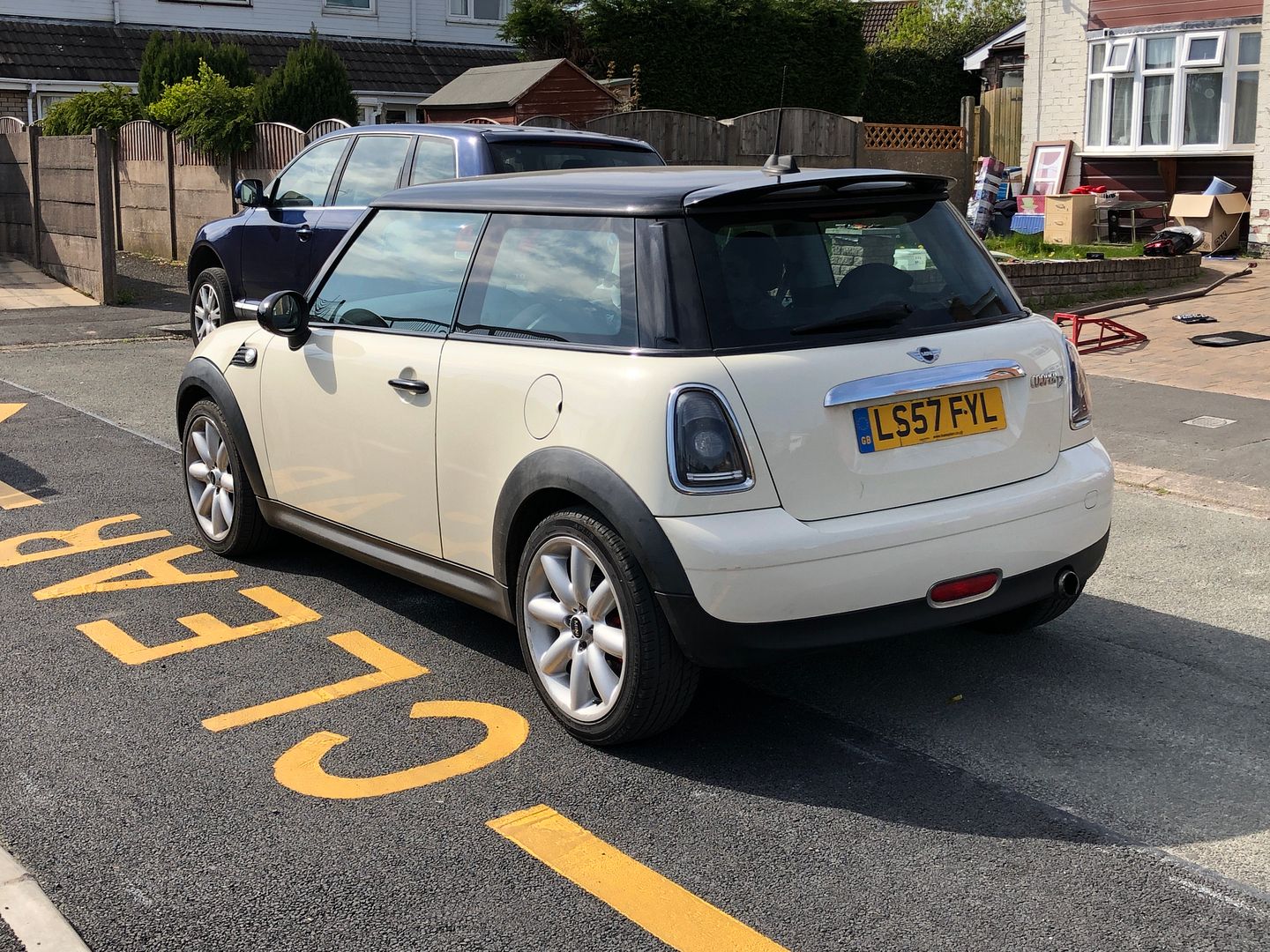

It was then on with the new exhaust
And Cooper bumper
That lot only took me about an hour and a half, was expecting it to take longer, next up, back to a simple job, rear lights

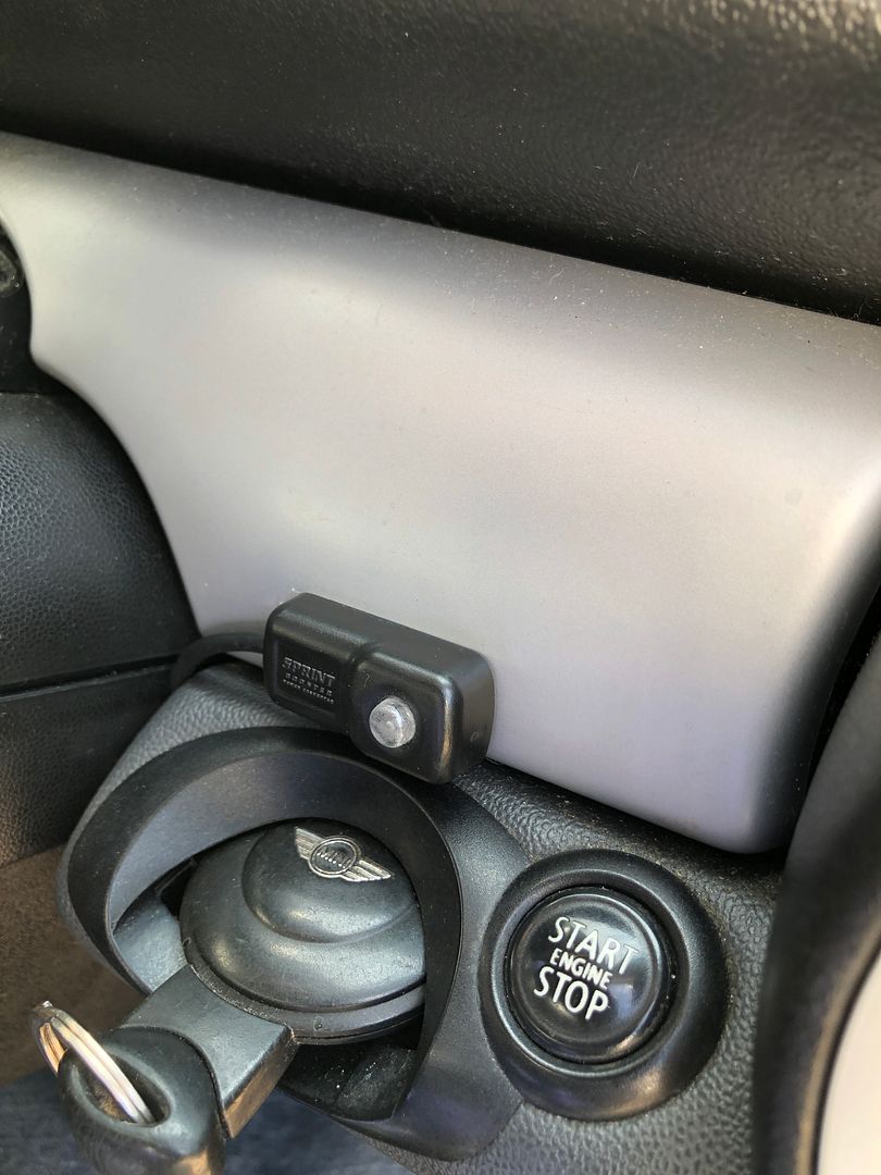

Then it was the sprint boost button, plugs into the accelerator pedal and has the button on the dash, similar experience to the ones I had in the Cooper and convertible

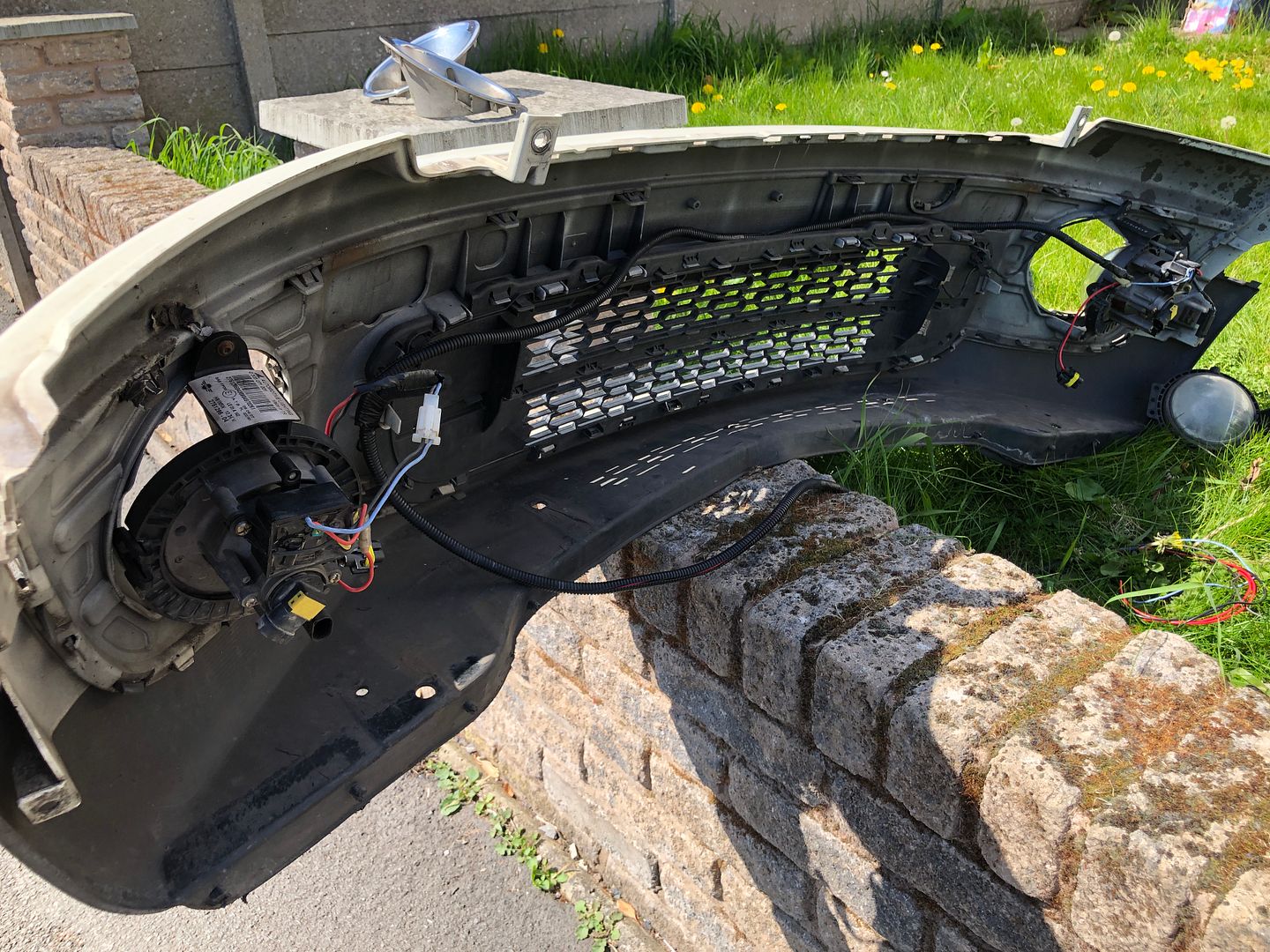

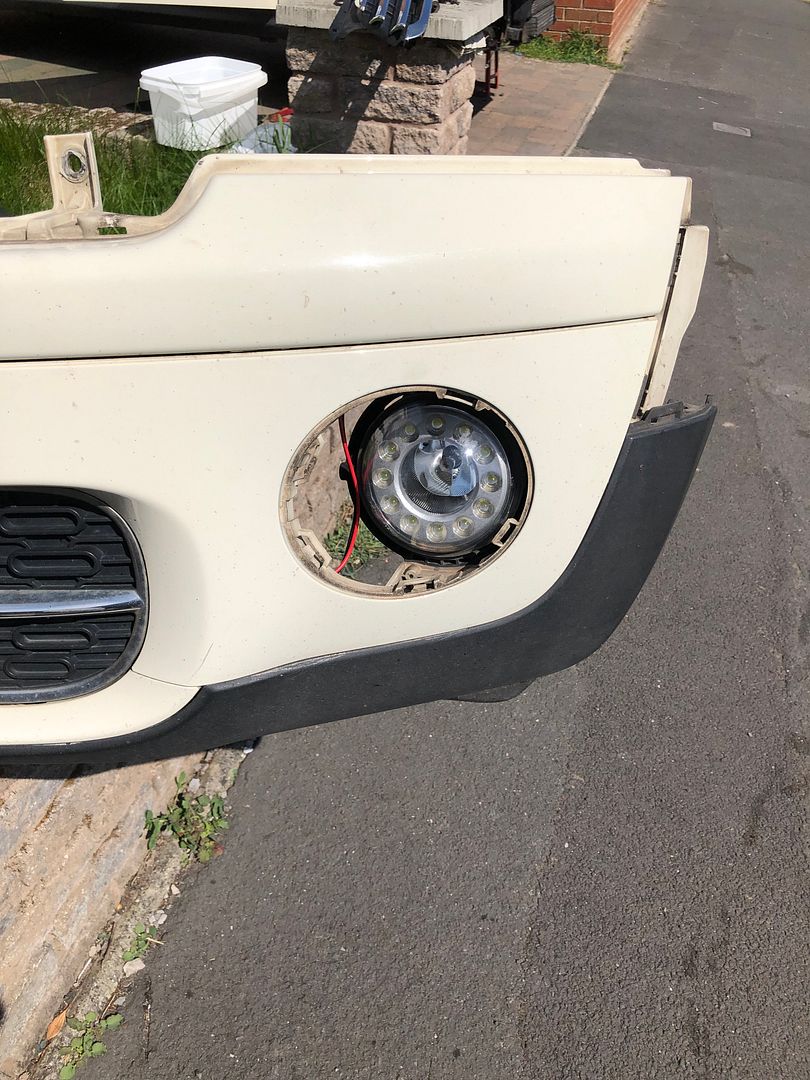

Then the one job I was going to put off as I didn’t fancy taking the bumper off but I thought, what the hell ive got plenty of time left
Daylight running lights, you may notice the chrome ring is missing, I’ve taken it off to plasticote it black
They are wired together and an extra loom runs to the battery, when the lights of off you get bright running lights but when the lights come on they dim down
