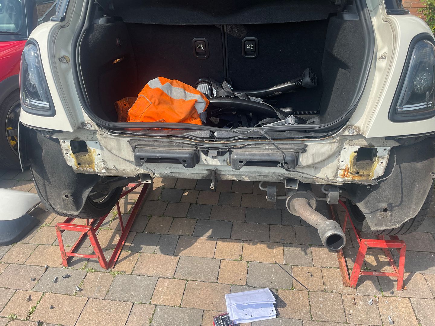

This morning little project…..
Jacked up
Towbar time

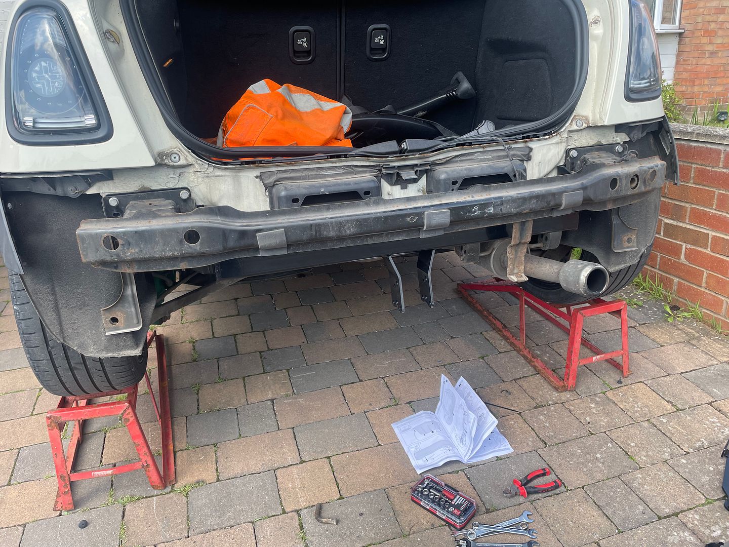

Bumper off
Crash beam off

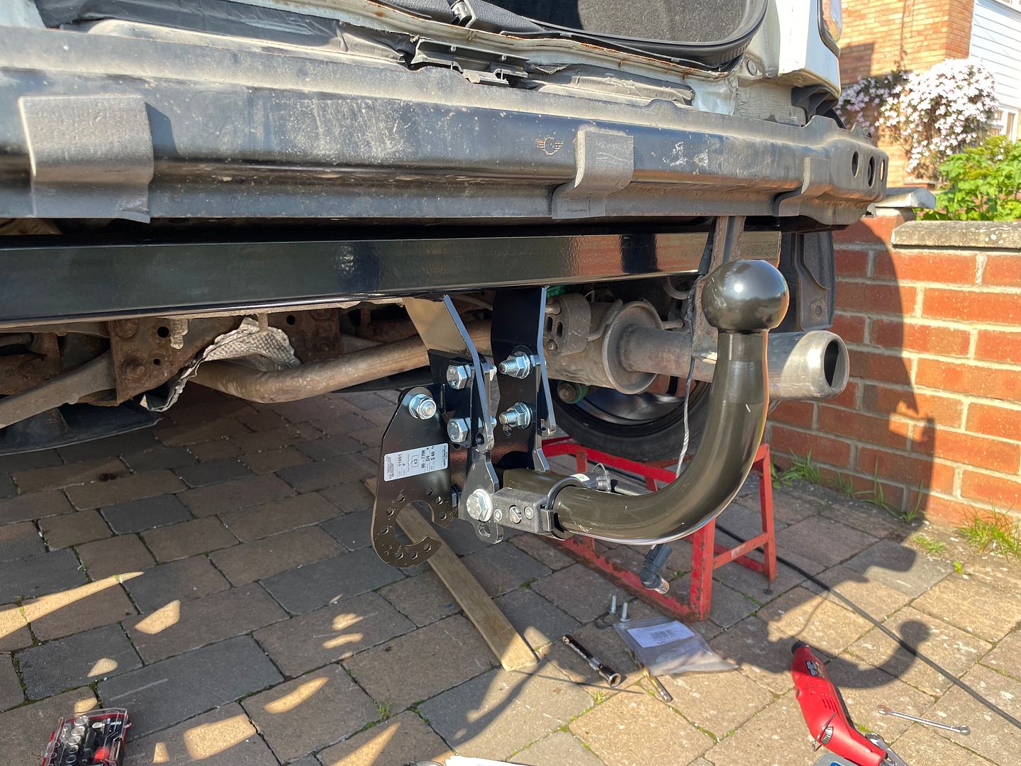

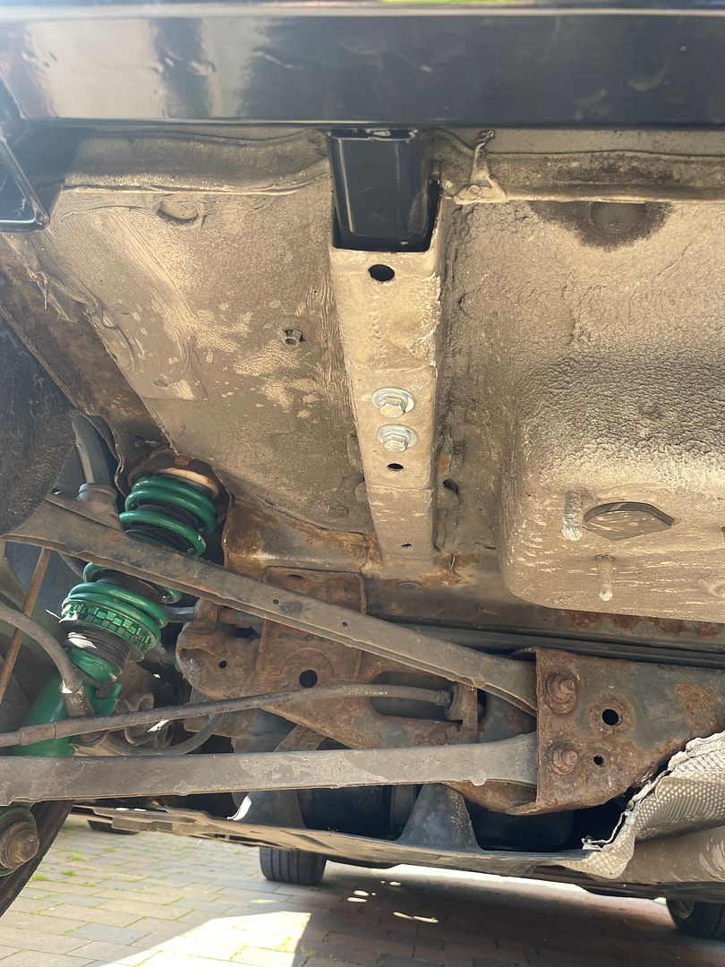

Towbar fitted and crash beam back in place
Bolts added underneath

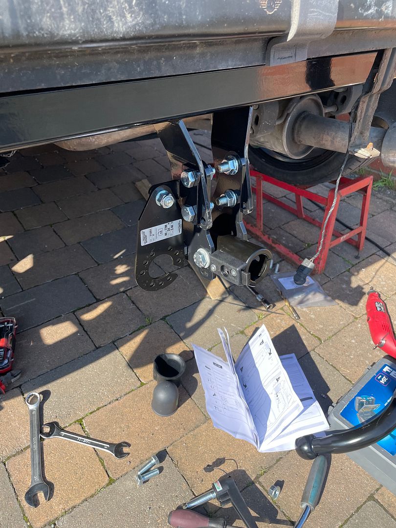

Towball gubbins
And the removable swan neck test fitted

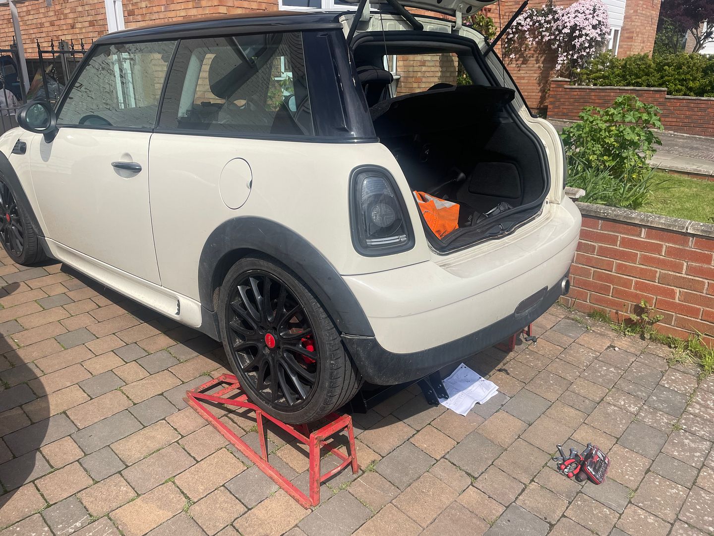

Bumper back on
And with the towball fitted
I can now tow my little trailer to the local tip but the real reason I got it is I can now fit the towball mounted bike carrier I have instead of the saris if I want, the only thing left to do is the electrics but i might get someone to do that for me, although it’s not too complicated really if I do it myself
