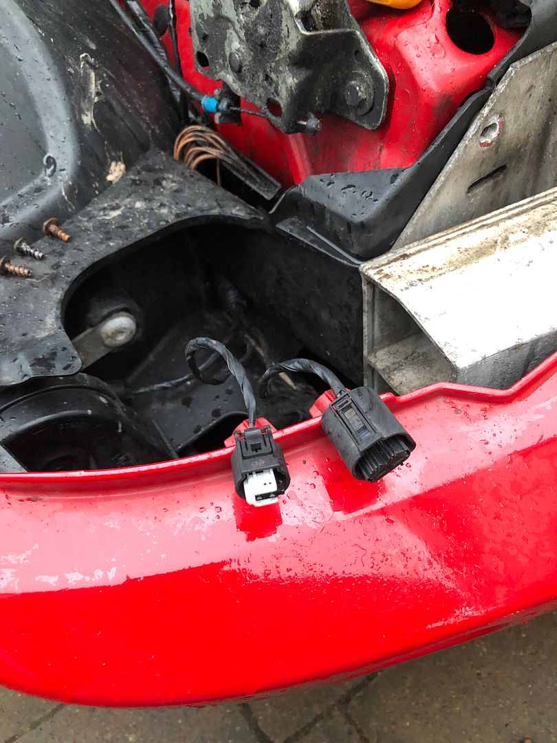

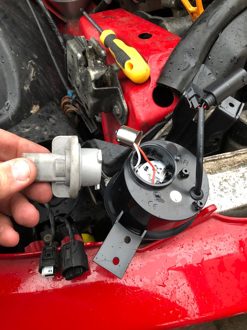

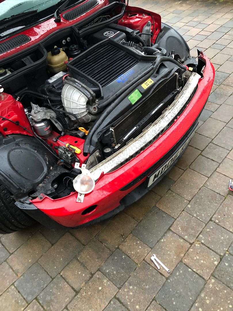

had a package arrive from kill all chrome too, halo DRL/Indicators
Nice and easy to fit, undo the top bolts of the bumper and remove the existing indicator assembly
existing wiring loom
Take the bulb holder out of the old assembly and fit the ‘dummy’ holder in place of the bulb then put that into the new assembly
Attach the wires to the assembly, you can see an extra connection on the new wiring
That has some sort of rectifier on it which can get hot so mount it on something metal to save melting any plastics, I’ve secured it in the slam panel with its sticky pad
And the finished article, the bumper was yet to be refitted properly as I wanted to check they worked ok, hard to see in the pics but the light has an outer white ring with the indicator in the centre
When the indicators come on the white light goes out
A bit better to see after dark
Out and about I was surprised how much extra light they gave, I bought them for asthetics but they are actually very good for actually doing the job of lighting the way
very impressed with them
Now I know I bought them from kill all chrome but if anyone is thinking of a group buy them I noticed a similar set on Amazon for £83 (about £7 cheaper) and it’s buy 3 get 1 free so if 4 of you got together then they will work out at £62 a pair

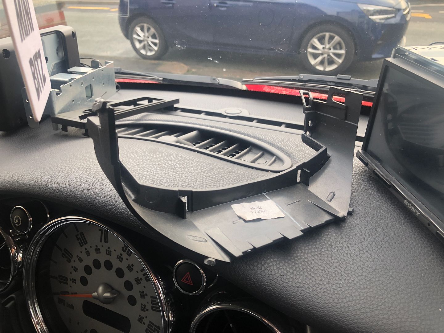

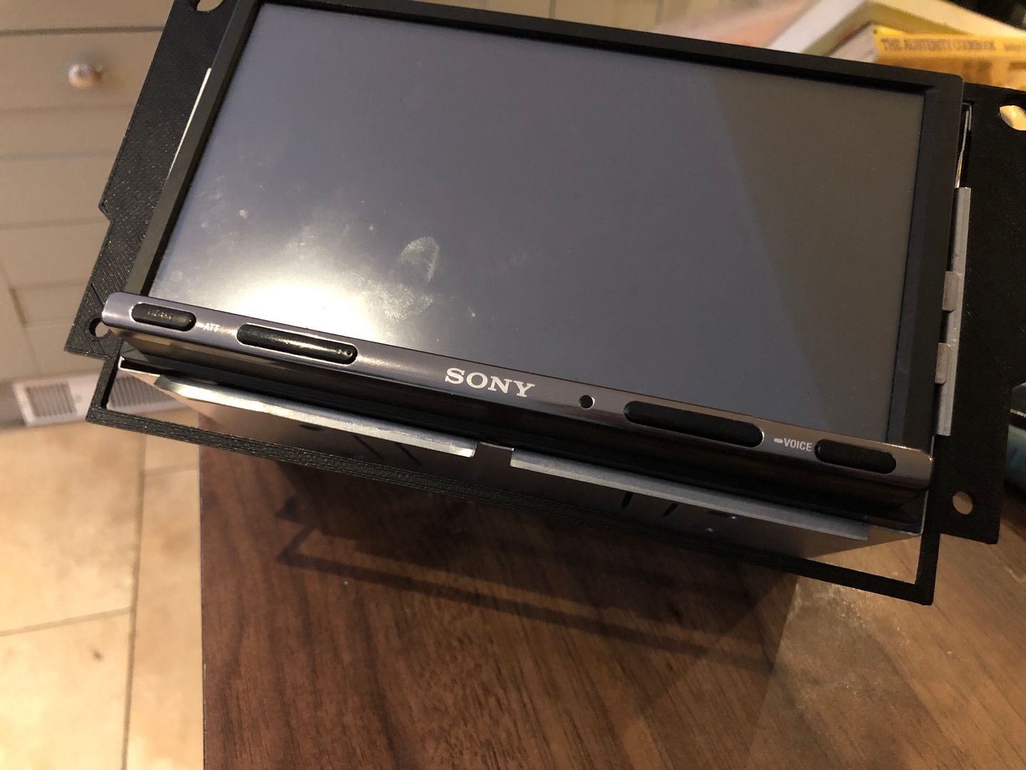

Another job I wasn’t going to do for a bit but had a day off and the weather with me.
Out with the old stereo
Cut out the cross section under the stereo hole
Then front the bottom of the dash
Which left me with this
In with a 3D printed double din facia plate
Which the heating and switch panels attached to
Cut the inside of the downtubes, this one is a bit rough and ready but as it’s hidden it doesn’t matter, I used a template that came with the facia, the other side I did with an angle grinder and it’s a much better finish!
Both tubes in place
Then it was the mounting cage and stereo, I’m just waiting on the outer facia as the seller forgot to post it
Very impressed with the facia, only a basic 3D print off eBay but worth every penny compared to the one I did myself in the blue car, this one is far more secure, got to take it back out again when I’m ready to wire the amp as I’ll need to connect a couple of wires up behind the unit and properly fit the usb connection in the glovebox
in all a good couple to three hours work

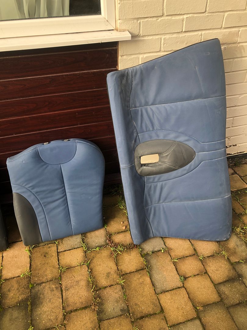

Of course they are the wrong colour to match the new sparco seats so I’ve done a bit of research and ordered some black leather dye to have a go at changing the colour, I’ve got a compressor and spray gun to put the dye on once I’ve done the prep work

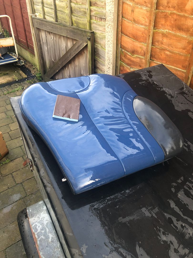

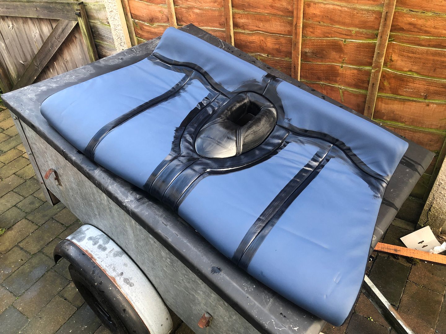

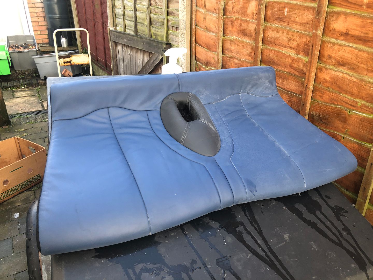

Quick job this morning before work, prepped the leather for dyeing
First up scrubbed the leather with a fine abrasive pad
That basically takes the shine and top coat off the leather finish
Once dry it was clean again with IPA on a cloth, this is it before cleaning
And this is it 1/2way through the IPA clean, the left hand side has been cleaned
And all clean
And once dry on with the dye, first coat on a sponge, working around the seams first
Then the rest of the seat with a sponge
And the same on the seat backs (and headrests)
You can see how the dye has gone on with the sponge on the first coat, doesn’t matter if it’s streaky as the next 2 coats will be going on using my spray gun and compressor, unlikely to get the next coat done until at least Tuesdayrhough
in the meantime the seats are I my mancave with the heating on low to make sure they are nice and dry ready for the next coat

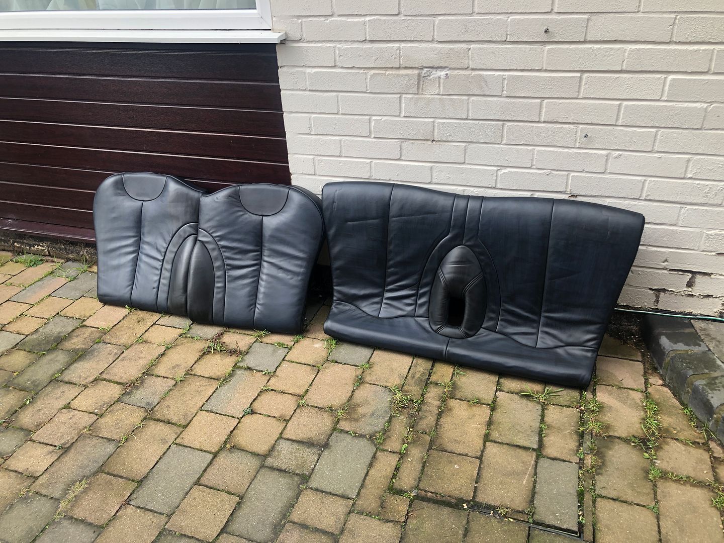

Yeah, had I been keeping them blue then I bet just an IPA clean would have bought them up lovely
even after the first sponge coat of dye they look quite good from certain angles so once the next couple of coats go on with the spray gun (low pressure mist I recon) they should look good, I’m going to store them for a week or so in the warm garage/mancave to ensure the dye has properly dried before I fit them too save any accidents on any clothing

And a final coat, left the heating on all night on low to help dry them quicker
