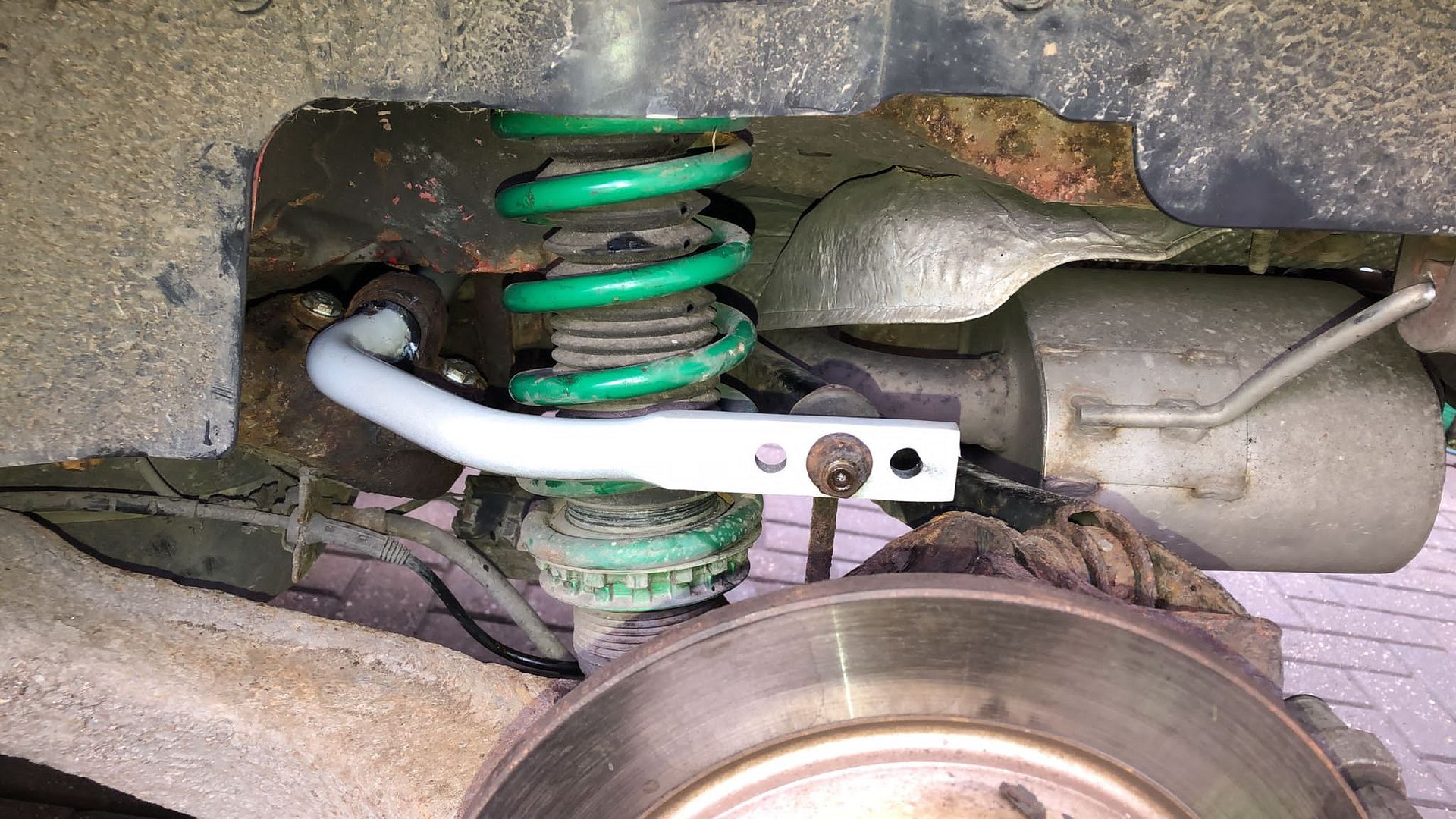

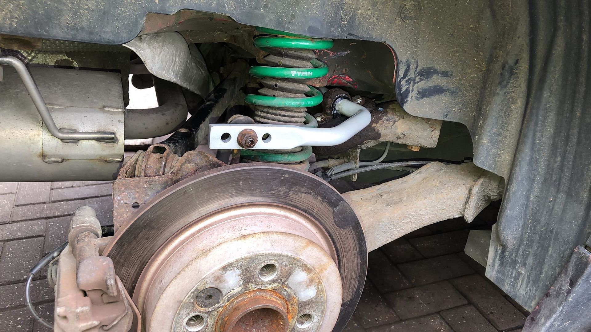

Seeing mention of the sale at Whiteline on another thread I’ve ended up buying a 20mm rear ARB for the car, with the 25% discount and a further £20 off for being a new customer and signing up for emails I’ve got it for £135
Sorting out with carsorbikes to get it to him for fitting along with having the janspeed manifold and sport cat refitted, I’ve been meaning to get that done for the last 12 months since the previous MOT, once that’s back on I’ll get it to 1320 for the tomcat and a retune

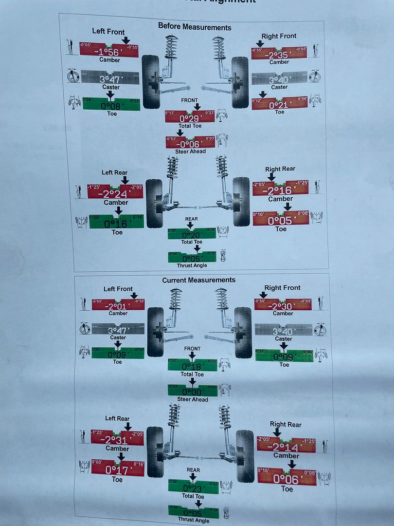

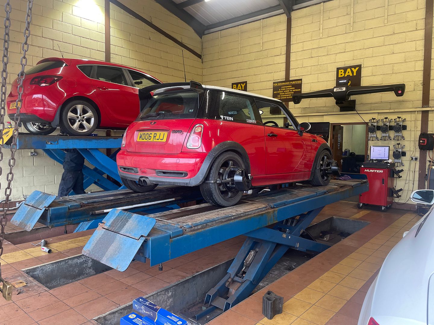

Booked in on Wednesday for the tracking to be done properly, after the new track rod ends were fitted the garage I use dropped it at a different garage to get the tracking done, anyway I was happy with it despite the steering feeling heavy so used the same garage to sort the tracking on my wife’s ‘new’ Mazda CX-7 as it was tramlining badly when I got it, it wasn’t until I went to get the Mazda done I realised he just used the old style mirrors and lasers on the floor jacking it up to align then going for a drive to ‘see how it felt’ admittedly it was an improvement on how it was before and supposedly ‘spot on’ but my wife said it still didn’t feel quite right so yesterday I took it to somewhere else who did it on the ramps and discovered one of the front wheels was 4 degrees out! I suspect the minis ‘spot on’ alignment may be similar so it’s going to Buckley tyres to be done properly as they have the geometry setting from when Sean took it to them before I bought it and they did a great job on my R56

Be interesting to see on Wednesday how much the tracking is out as it did feel heavy going again at times today

Had the tracking done today, didn’t bother with the 4 wheel alignment as the subframe is getting dropped to fit the rear ARB
it was toeing in a bit at the front, also one of the tyres only had 15psi in so that obviously won’t have helped it feeling heavy!
certainly a lot better on the drive home though,All ready to be dropped off with Sean tomorrow morning, manifold, sports cat and whiteline ARB to be fitted
Going to drop it off with him and ride my bike back to Chester if the weather is decent, not been out on it for a while so need to get back into the swing of it again
car safely dropped off with Sean, cycled back to Chester from his house as planned, 18 miles, im so out of shape from not using the bike it was hard going, struggled after about 15 miles on the gentle climb into Chester!
4
ARB already fitted and the rear shocks bounce back adjusted to firm it up, seem they were set to quite a bouncy setting!

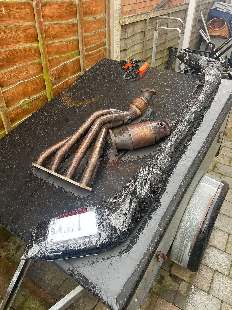

Manifold and sport cat refitted
Bit if a rattle onthe centre pipe but sounds nice, hopefully be able to go and collect it on Thursday
ARB Needs putting on the tightest setting mate.
