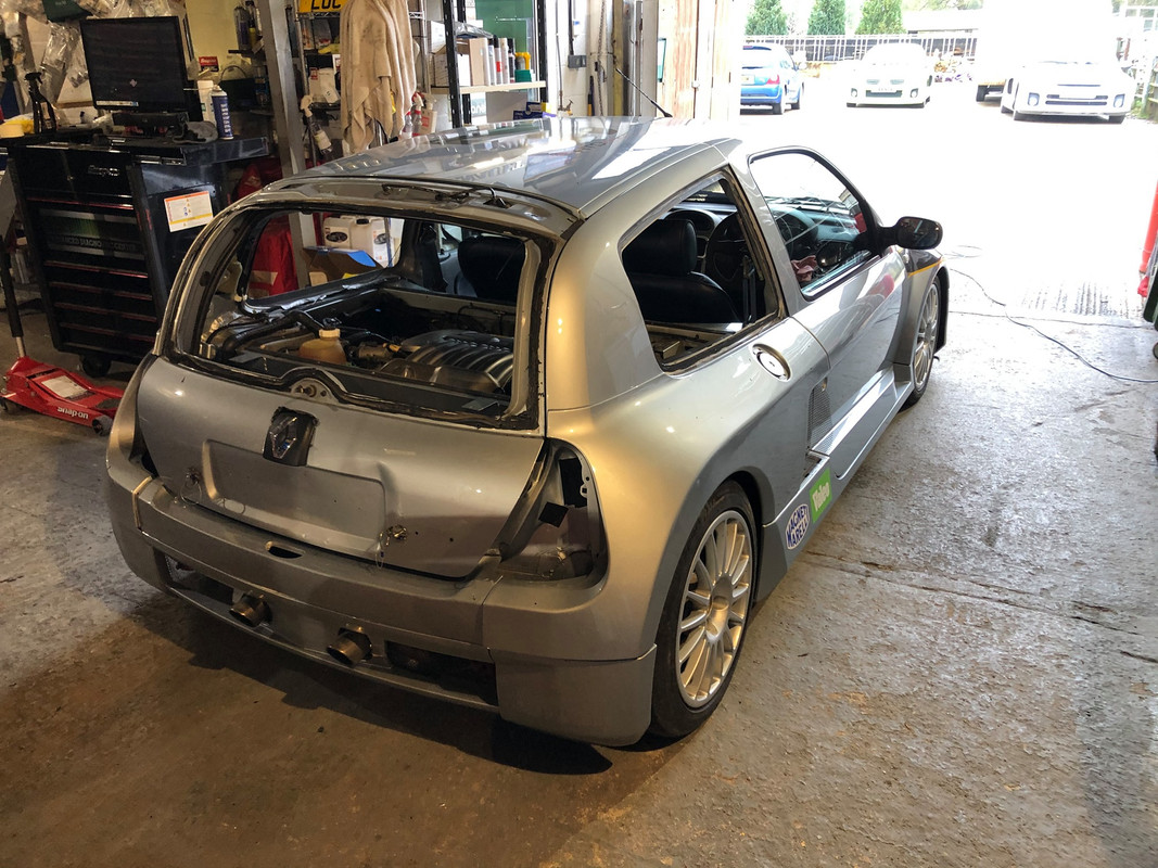

Repairs are now well under way.
Scott uses a place in Bristol for his bodywork stuff, Peels Motorkraft, so it's now in their hands.

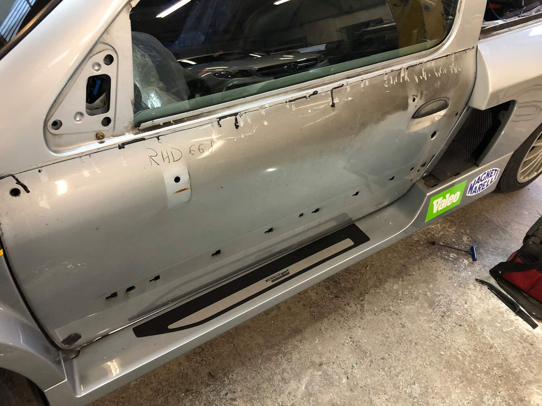

A crack was found in the composite part of the n/s door so both sides were removed for further checks, the rear wing composite parts were found to have had the bonding broken due to the impact.
The rear beam wasn't playing ball when it came to being straightened so they've fitted a new one. Where they found that from I have no idea as it's a specific V6 part.
Quite an impressive job Peels are doing. Once they've done it'll be back over to Scotts for him to do his bit. The wrap will be replaced whilst he has it but the decals will be reapplied once I have it back.

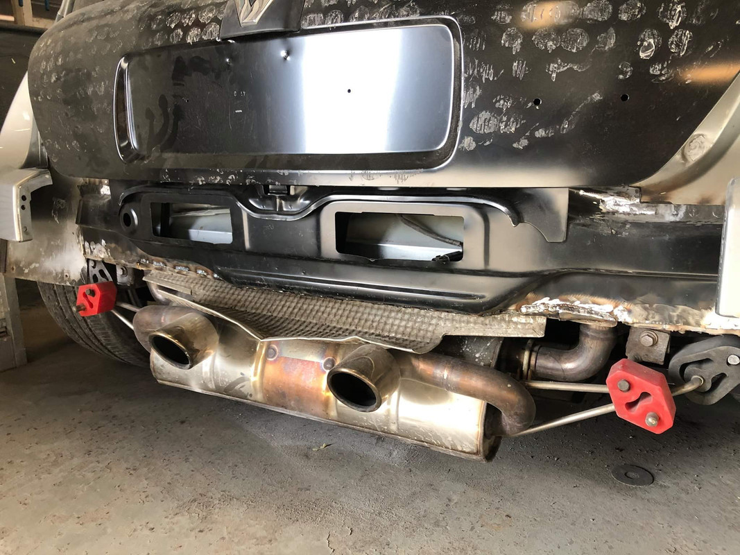

Amongst the other things Scott has to do is to weld 90mm rolled exhaust tips on.

The exhaust is SS including the pipework so will clean up well although the back box may yet be covered with a plain sheet of SS.

Glass is going back in on Wednesday and the plastic part that sits inside the rear bumper has been cut to fit so it doesn't fill up with crap.
The exhaust is going to be the biggest difference, the attached pic shows the difference between the old and the new tips. The outlet pipework from both sides of the back box is being removed as it's too small. 2 x 3" pipes will come directly out of back of the back box and the tips go straight onto those. The back box is now definitely being covered with a piece of plain SS.
Should look suitably mad
